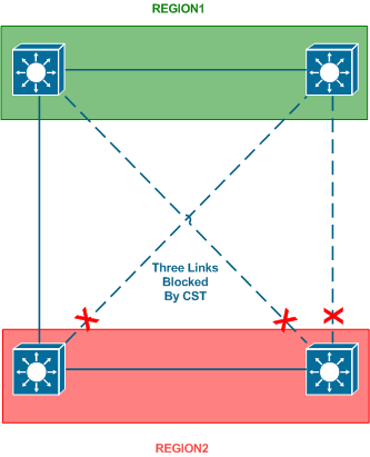

    Common Spanning Tree (CST)
    From the above information, we may conclude that CIST essentially has a two-level hierarchy. The first level treats all regions as “virtual bridges” and operates with the External Root Path Cost. The first-level spanning tree roots in the CIST Root Bridge and encompasses the virtual bridges. This spanning-tree is known as CST or Common Spanning Tree. The CST connects all boundary ports and perceives every region as a single virtual bridge with the Bridge ID equal to CIST Regional Root Bridge ID.
    mstp-3-multi-region-cst-and-vbridges
    CST is the construct where MSTP interoperates with the IEEE STP/RSTP regions as well. The legacy switch regions join their STP instance with the CST and perceive MSTP regions as “transparent” virtual bridges, staying unaware of their internal topology. Thus, connecting to IEEE STP/RSTP domains extended the CST. MSTP discovers the appropriate STP version on a boundary link by listening to external and switches to the respective mode of operations (e.g. RSTP/STP). It may happen so that a switch with the lowest Bridge ID belongs to a RSTP/STP region. This situation results in all MSTP regions electing local CIST Regional Roots and considering the new CIST Root located outside the MSTP “domain”.
    The second level of CIST hierarchy consists of the various MSTP regional ISTs. Every MSTP region builds an IST instance using the internal path costs and following the optimal “internal” topology, using the CIST Regional Root as the IST Root. The changes to CST may affect the IST’s in every region, as those changes may result in re-electing the new CIST Regional Roots. Changes to the region's internal topologies normally do not affect the CST, unless those changes partition the region.
