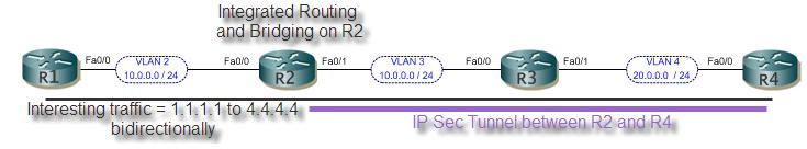

    Bob made his plan using the following diagram:
    Bob's VRF / IPSec / Transparent Diagram (or as Bob calls it, the "VITD"
    Bobs plans included R2 as a transparent mode router, using a VRF, with a Bridged Virtual Interface (BVI) on the 10.0.0.0 network.  All interfaces on R2 belonging to the VRF named vrf1.   R4 and R2 will be IPSec peers, with interesting traffic being IP between 1.1.1.1 and 4.4.4.4 bidirectionally.
    Doing the best he could with this new technology, Bob put together a proposed configuration based on examples he had seen.  The VLAN configuration on the switch was correct, and for this blog post, we will accept that the switch configuration is 100% perfect.  (I know, I know...  A real CCIE doesn't assume anything is working correctly unless he/she verifies it.   So for this task, I personally verified that all VLANs were correctly assigned, and that any trunking that may be required for inter-switch communications was also set up correctly).
    Bob pasted in the configs, and hoped for the best.  Bob discovered that he could not even PING from R2 to any other device on the network.   "Could PING be broken by VRFs?" Bob thought to himself.   He had only read about VRFs and this was his first exposure to them.
    Bob has officially sounded the call, once more, for you to help  him with his broken configuration.

    There is more than one possible solution.    Using the framework of what is provided, including the diagram, there are nine (9), corrections that are required for this configuration to work.   The goal is to have an IPSec tunnel, between R2 BVI1 and R4 20.0.0.4   A ping sourced from 1.1.1.1 destined to 4.4.4.4 should be encrypted over the tunnel.
