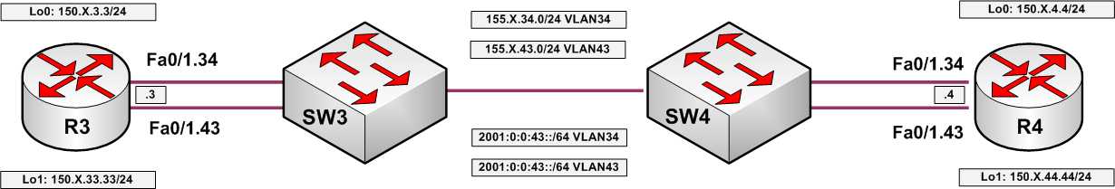

    Consider the following test topology:
    Cat3550-QoS
    With the next example we will classify three traffic types on a single port: RIP updates, ICMP packets and IPv6 traffic. We will use policy-map to assign the IP precedence and CoS values to the packets accordingly.

    Verification: Create an access-list on R4 to match the IP packets
    R4:
    no ip access-list extended MONITOR_34
    permit udp any any eq 520 precedence 3
    permit icmp any any precedence 4
    permit ip any any
    interface FastEthernet 0/1.34
    ip access-group MONITOR_34 in
    Send ICMP packet at a rate enough to kick in the policer exceed action:
    Rack15R3#ping 155.15.34.4 repeat 50 size 1000
    Sending 50, 1000-byte ICMP Echos to 155.15.34.4, timeout is 2 seconds:
    Success rate is 90 percent (45/50), round-trip min/avg/max = 4/4/9 ms
    And verify the access-list at R4:
    Rack15R4#show ip access-lists MONITOR_34
    Extended IP access list MONITOR_34
    10 permit udp any any eq rip precedence flash (18 matches)
    20 permit icmp any any precedence flash-override (135 matches)
    30 permit ip any any (9 matches)
    To check if IPv6 packets are matched by MAC access-list, send highly saturated stream of ICMPv6 echo packets to R4:
    Rack15R3#ping 2001:0:0:34::4 repeat 50 size 1000 timeout 1
    Sending 50, 1000-byte ICMP Echos to 2001:0:0:34::4, timeout is 1 seconds:
    Success rate is 82 percent (41/50), round-trip min/avg/max = 4/7/8 ms
