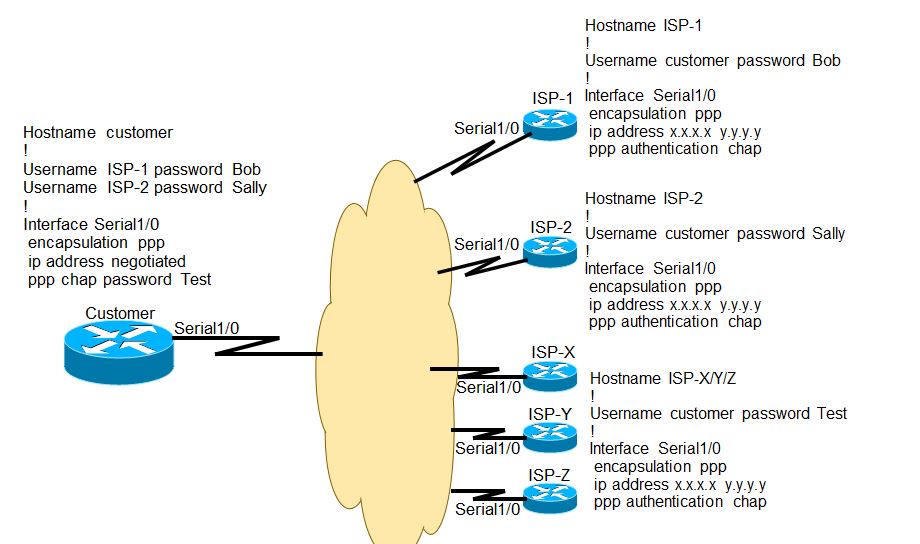

    If you have a situation where you expect that the Customer Router might be using this same interface to "call" multiple remote destinations, and use a different CHAP password for each remote location, then you could add the following:
    Customer router placing the outgoing PPP call to ISP-1 (CHAP password = Bob) and ISP-2 (CHAP password = Sally):
    hostname Customer
    username ISP-1 password Bob
    <em><strong>username ISP-2 password Sally</strong></em>
    interface Serial1/3
    encapsulation ppp
    ppp chap password cisco
    ip address x.x.x.x y.y.y.y
    Notice in the example above, the "username x password y" commands supercede the interface-level command, "ppp chap password x". But please note that the customer (calling) router always needs the "ppp chap password" command configured at the interface level.  A global "username x password y" in the customer router does not replace this command.  In this situation, if the Customer router placed a call to ISP-3 (for which there IS no "username/password" statement) it would fallback to using the password configured at the interface-level.
