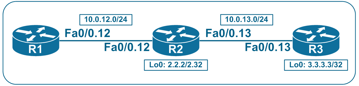

    To illustrate how this works in IOS, take the following topology as below.  R1, R2, and R3 are connected in serial; R1 will be the traceroute source and R3’s Loopback 3.3.3.3 the destination.

    R1 first sends three probes with a TTL of 1.  R2 receives these, decrements the TTL to 0, and replies back with ICMP Time Exceeded.  R1 then increments the probes to TTL 2 and repeats.  R3 receives them, sees itself as the final destination but that it does not have a service listening at the requested port, and replies back ICMP Port Unreachable.  The details of this flow can be seen in the debug outputs below.
