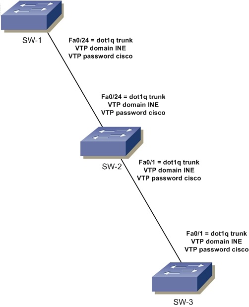

    Can you predict the results of a 3 switch VTP client/server scenario?
    SW1-3, are connected, as shown in the diagram.
    VTP question for Blog
    Here is the initial output of show VTP status, and show VLAN brief on each. Note that SW1 and SW3 are servers, while SW2 is a client.   We will be adding a failure to the network in just a moment.

    So here is the scenario for the question. The Fa0/24 connection is suddenly broken between SW1 and SW2, and while that is down, a new VLAN (we will use 999)  is created on SW3 like this:
    <strong>SW3(config)#vlan 999</strong>
    And then, a few minutes later, SW3 is completely powered off, shipped to another city, and removed completely from this network forever.
    If we then restore the Fa0/24 connection between SW1 (the server) and SW2 (the client) what will happen to the VTP/VLAN information on the two switches? Will there be an update on either switch, will SW1 wait for a Server advertisement or will something else happen all together?
