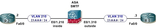

    Here is the diagram we can work with:
    SMTF-Single Mode Trans Firewall with ARP Inspection

    Here are the relevant portions of the configuration on the ASA:
    firewall transparent
    hostname ASA1
    interface Ethernet0/1
    no nameif
    no security-level
    interface Ethernet0/1.210
    vlan 210
    nameif inside
    security-level 100
    interface Ethernet0/1.310
    vlan 310
    nameif outside
    security-level 0
    access-list free extended permit ip any any
    access-list OSPF extended permit ospf any any
    ip address 23.0.0.10 255.255.255.0
    access-group free in interface inside
    access-group OSPF in interface outside
    Here are the relevant portions of R2 and R3.  Notice that we hard-coded the mac addresses so that spotting them and knowing who they belong to will be super easy:
