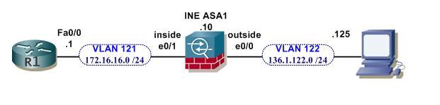

    After returning from vacation, Bob (the optimistic firewall technician) decided that he wanted to take some time and get a little bit more familiar with firewall configuration. He was able to get permission to use some spare equipment for practice.
    marvin_9-25[1]
    He started with a basic configuration on the firewall:
    hostname INEASA1
    password cisco
    enable password cisco
    interface e0/1
    nameif inside
    no shut
    ip address 172.16.16.10 255.255.255.0
    security-level 90
    interface e0/0
    nameif outside
    ip address 136.1.122.10 255.255.255.0
    security-level 10
    no shut
    Bob verified that he could ping both R1 and his PC from the Firewall. Now, he wants to configure the firewall to allow telnet from his PC. He remembers that there was some additional configuration that needed to be done on the firewall to allow this to work, but doesn't remember exactly what is needed. Since his PC isn't connected to the internet, he is not able to access the online documentation.
    What additional configuration will allow Bob to telnet to the firewall from his PC?

    OK, so let's look at the problem here. The PC is on the outside of the firewall, and according to multiple responses, you can't telnet to the outside interface. (or can you?)

    1. Configure the switch so that Bob's PC is on VLAN 121 instead of VLAN 122, configure the firewall to allow telnet on the inside interface. (Technically would meet requirements, but not much of a challenge.)
    2. Change the security levels for the interfaces, making them the same or making the outside higher.
    3. Add another interface with a lower security level
    int eth0/1.1
    vlan 123
    nameif DMZ
    sec 9
    4. Configure a VPN for the firewall, so that the telnet traffic to the lower security (outside) interface is encrypted and therefore allowed.
    5. Configure the firewall to allow transit traffic through to R1. Telnet to R1, and then Telnet to the ASA from R1, after configuring the ASA to allow telnet on the inside interface.
