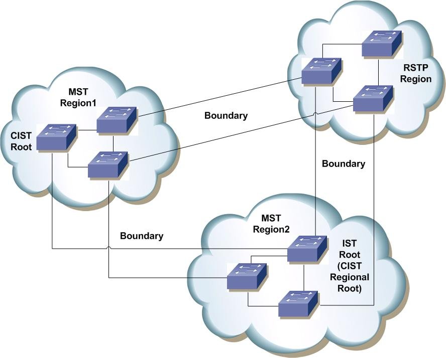

    The concept of CIST
    As you remember, every MSTP region runs special instance of spanning-tree known as IST or Internal Spanning Tree (=MSTI0). This instance is active on all links inside a region and serves the purpose of disseminating STP topology information for other STP instances. As usual, IST has a root bridge, elected based on the lowest bridge ID (priority/MAC address). However, situation changes when you have different regions in the network (e.g. switches with different region names, different revisions, etc). When a switch detects BPDU messages sourced from another region on any link, it marks the link as MSTP boundary. On the figure below you can see two MSTP regions connected via two separate links (disregard the RSTP region for now).
    Now two regions should build a common spanning tree known as CIST – Common and Internal Spanning Tree. This tree is result of joining ISTs of each region in a special manner. Here is a detailed description of the process.
    1) In addition to sending IST configuration BPDUs, every switch initially declares itself as the root of CIST. The switches pass CIST configuration information along with IST information in additional BPDU fields. Switches inside a region never change the path cost to the CIST Root, known as CIST External Root Path Cost. Instead of that, the external path cost only changes on the boundary ports. Thus, this external cost only accounts for the cost of boundary links, not the cost of the paths inside a region. Essentially, CIST External Path Cost information “tunnels” across a region.
    2) On boundary ports, switches exchange their CIST BPDU information ONLY. That is, switches hide IST information between regions, but pass CIST metrics. The usual RSTP synchronization process takes places between switches on a border link, and eventually ONE switch with the lowest BID (Bridge ID = Priority + MAC Address) among all regions is elected as the CIST Root. Note that each region still elects a local IST root, known as CIST Regional Root, as described further.
    3) The region that contains the CIST Root, declares this switch as the root of local IST as well. However, things start to differ for regions that don’t contain the CIST root. All of them elect one of the border switches (switches connected to other regions) as IST root (aka CIST Regional Root). This procedure elects the IST Root (CIST Regional Root) based on the lowest CIST External Root Path Cost. Note that this procedure differs from elections based purely on BID, which take place inside a single region. In this case, the procedure uses BIDs as tiebreaker, if two or more switches have the same CIST Root External Path Cost. MSTP blocks all redundant boundary “uplinks” marking them as “alternate” paths to the CIST Root. The boundary switches do so by receiving “extra” CIST BPDUs on top of IST BPDUs with external root path cost values and comparing them with the ones received on local boundary ports.
    4) Inside a region, switches build regular IST, using the CIST Regional Root as the root of IST. Note that this tree uses so-called Internal Root Path Cost stored in the local IST BPDUs. This cost increments along all the links inside a region, but it never leaks out of the region. Between regions, switches exchange information about CIST External Root Path cost only.
    Note that switch with non-optimal priority value may become the CIST Regional Root (local IST Root). For example, if you configure a switch inside a region with a lowest BID among all switches it may not necessarily become the CIST Regional Root. Only if the switch has the lowest BID among all regions it would be elected as CIST Root.
    The concept of CST and STP interoperation
    From the above information, we conclude that CIST essentially has organization of a two-level hierarchy. The first level treats all regions as “pseudo-bridges” and operates with the External Root Path Cost. The first-level spanning tree roots in CIST Root Bridge and encompasses the pseudo-bridges. They call it CST or Common Spanning Tree. Effectively, this has no idea of the internal MSTP regions structure, but sees each region as a virtual bridge.
    This is the point where MSTP interoperates with legacy IEEE STP/RSTP regions as well. The legacy switch regions have no concept of IST, so they simply join their STP instance with the CST and perceive MSTP regions as “transparent” pseudo-bridges, staying unaware of their internal topology. (Note that it may happen so that a switch with the lowest BID belongs to RSTP/STP region. This situation results in all MSTP regions electing local CIST Regional Roots and considering the new CIST Root located outside MSTP “domain”). Naturally, MSTP detects the appropriate STP version on a boundary link and switches to the respective mode of operations (e.g. RSTP/STP).
    The second level of CIST hierarchy consists of various regional ISTs. Every MSTP region builds IST instance using the internal path costs and following the optimal “internal” topology. As you remember, this “internal topology” transparently transports the “external” BPDU information to the border switches, so that they can elect Regional CIST Root. The fist level topology (CST) is somewhat independent of the second level topology (IST) and bases upon the CIST root and cost of the boundary links. The second level topology (“internal”, IST) may change in case if boundary link cost changes or something happens to the CIST Root, since this affect the election of the Regional CIST Root.
    MSTP pseudo-bridges do not strictly emulate the real bridges. For example, different boundary switches send their own BID in BPDUs, so the pseudo-bridge may appear to have many BIDs on various boundary links. However, this has no impact on the process of transparent tunneling of CIST Root information across the pseudo-bridge. Other things that don’t see pseudo-bridge as non-transparent include MSTP hop count or MaxAge timer value, for they may change asynchronously, as information travels along different paths inside a region.
