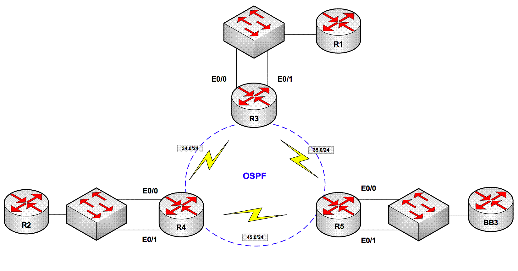

    Let model a situation where we have a number of routers connected over (PSN), with an ethernet switch connected to router at every location:
    VPLS with L2TPV3
    What we can do, is connect ethernet ports using pseudowires to form a virtual ring topology over PSN. That is, refeferring to our picture, xconnect routers' ethernet ports counter-clockwise, say xconnect E0/0 of R3 with E0/1 of R4, then E0/0 of R4 with E0/1 of R5 and finally E0/0 of R5 with E0/1 of R3. Effectively, we will form an ethernet ring, partially connected over convenient switches, and partially using L2VPN pseudowires. Router configurations look pretty much similar, for example at R3 we would have something like this

    Speaking honestly, it's not "classic" VPLS in true sense:
    Firstly, STP should be running over ring topology, in order to block redundant ports. One can use star topology and disable STP, but this will introduce a single point of failure into the network. Classic VPLS does not run STP over packet core, only a full-mesh of pseudowires.
    Secondly, there is no MAC-address learning for pseudowires, since they are point-to-point in essense. MAC addresses are learned by switches, and this impose a usual scalability restriction (though cisco switches may allow you to scale to a few thousands of MAC addresses in their tables).
    However, this is funny and simple example of how you can use a simple concept to come up with a more complicated solution.
